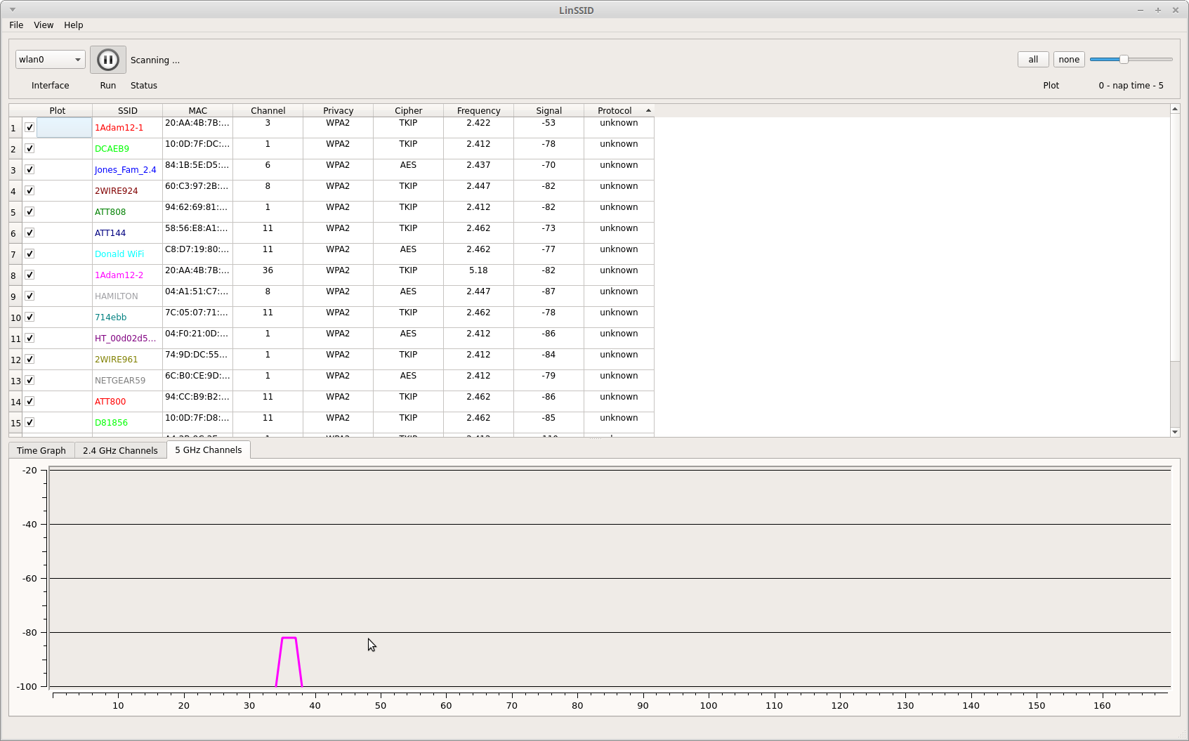

LinSSID @ 5 GHz

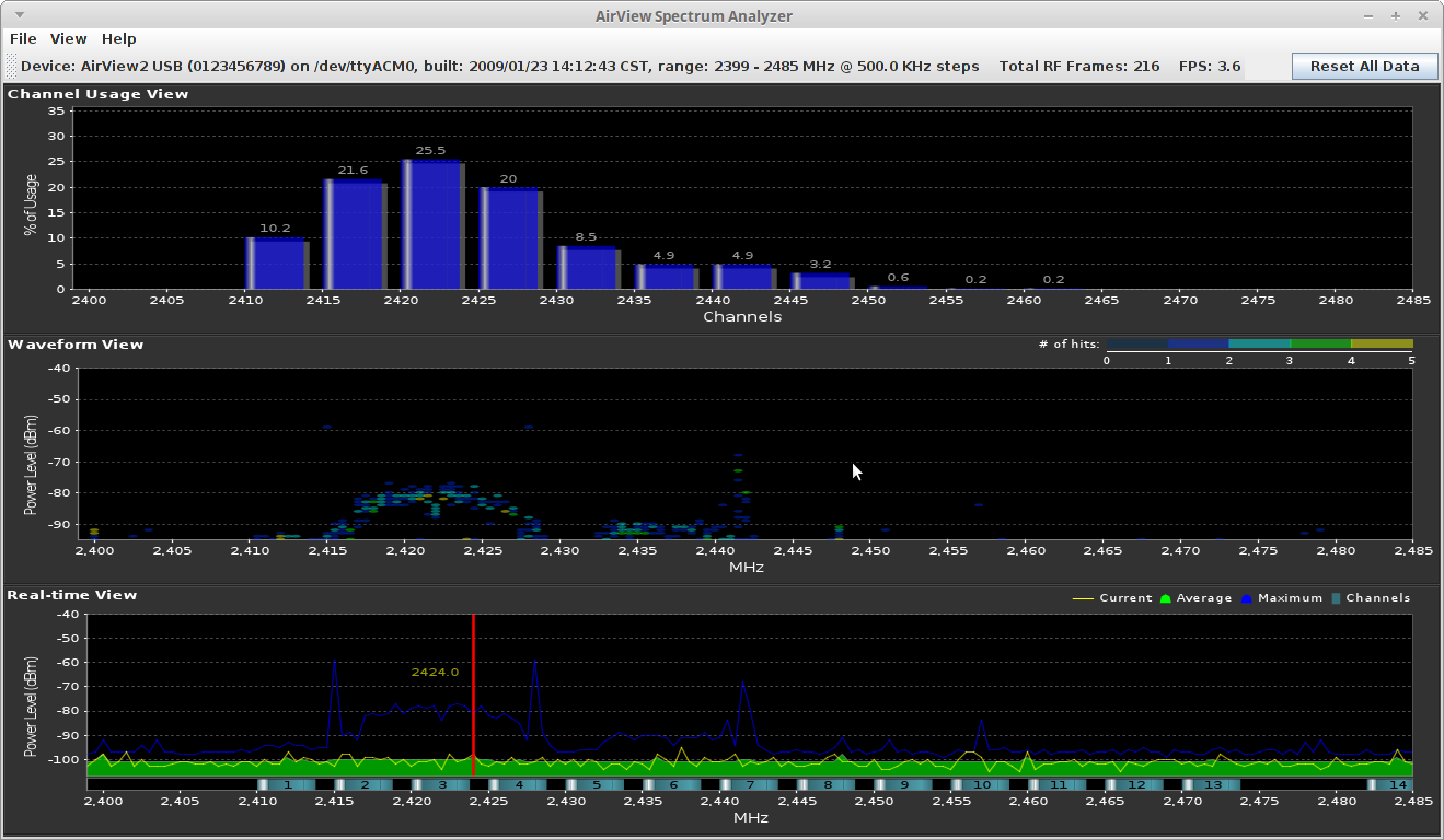

Airview2 @ 2.4 GHz
AirView Spectrum Analyzer_2.4 GHz.png (103.55 KiB) Viewed 15066 times
Findings
1. In my location, the 2.4 GHz band is crowded. LinSSID has identified 12 Access Points in my immediate vicinity. Airview2 also indicates significant signal activity in the band. It is likely that some of what Airview2 is showing represents non-WiFi activity by other devices.
2. The 5 Ghz band is practically empty. LinSSID is only detecting my wireless router in this band (SSID: 1adam12-2, Color: purple).
3. In the 2.4 GHz band my router is operating on channel 3 (SSID: 1adam12-1, Color: red) and is experiencing 15 MHz of overlap with other nearby APs, so adjacent-channel interference is a distinct possibility.
Planned Course of Action
1. Move all dual band capable WiFi client devices from crowded 2.4 GHz band to un-crowded 5 GHz band.
2. Experiment with changing 2.4 GHz AP channel. However, based on the LinSSID 2.4 GHz graph shown above, changing the channel to 1, 6, or 11 may result in co-channel interference which is worse than the adjacent-channel interference I am experiencing on channel 3.
